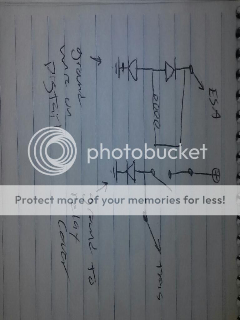

This is how the relay is wired internally.
Two of the diodes are attached to to the terminal out to the lean burn module. They seem to serve rectify an AC signal.
The other diode is between the terminal for the solenoid wire and the metal relay housing that is grounded to the firewall.
There seems to be no direct internal connection between the ground wire on the pigtail and the body of the relay.
I don't know if the pigtail ground is switched, but in all the conditions I checked, there is continuity to ground.
If you do do this, consider adding a connection from the brake light switch.
That is a good idea that I have entertained myself, actually. (I suggested it on another thread, then another member further suggested putting a pressure switch on the governor pressure test port, making the whole thing automatic--I'm not sold on the latter just yet.)
It does raise a question that I was not considering when pondering why the pigtail ground is isolated from the relay body ground: Does the brake light switch switch off the ground to the relay?
My wife has the van out right now.
When she returns I'll see if the ground wire of the pigtail loses grounding when the brake pedal is depressed.
I still can't think of why there is a diode on the solenoid wire. The switched battery voltage and solenoid wire are totally isolated from the potentially AC signal wire.

Actually, two of the diodes in the relay are there for protection. They are there to suppress the back emf from the relay coil and the LU solenoid. All relay or solenoid coils create a high voltage current when d-energized. Similar to an ignition coil.
The diode across the relay coil suppresses (shorts out) that current, as does the one across the solenoid connection. And yes, dropping the ground through the brake switch sounds right. Just for giggles, see if you have power on that wire when the brake is depressed. I bet they ground the relay through the brake light bulbs, hence the need for the third diode. Or, look at the brake switch and see if it has three or four wires, instead of the usual two.

Thanks for the explanation of the diodes.
