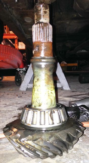

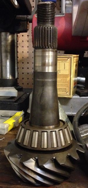

(2) This is more troublesome. The ring, pinion, and carrier i am planning on installing all came out of one axle. I believe the axle was an 8.25 out of an early 70s Dodge van. However, upon inspecting the pinions from the two gear sets, I noticed that the 2.2 pinion has a small crush sleeve that sits on a lip machined into the pinion shaft but the 3.2 pinion has a much longer crush sleeve that rests on the rear pinion bearing cage. Here are some pictures:
2.2 pinion:
3.2 pinion:

The crush sleeves are clearly different and incompatible. The 3.2 pinion lacks the machined lip for the small crush sleeve to sit on.
I am worried that I might have grabbed a gearset out of axle that is not an 8.25 axle. Every company I find that sells crush sleeves for 8.25 axles sells the small ones like were on the 2.2 pinion. I can't find anyone selling the long crush sleves like was present on the 3.2 pinion.
Am I hosed? Did I get an incompatible gearset?

There is more then one way to set pinion depth or set the bearing pre-loads...
Example: I have seen the pinion depth shim(s) under the bearing race, instead of being under the pinion bearing itself. Either install position yields the same result.
As for the crush sleeve, long or short, it needs to position the front bearing so it has the correct pre-load. These days, the crush sleeve is replaced with a solid spacer and pre-load set with thin shims.
So it is time to take some measurements...
If spline count, bearing journal sizes and positions are the same, do a trial assembly to see if you can get the proper gear contact pattern & bearing pre-loads.
If you can, set- the unit up and give it a try.

Near as I can figure, because the gears came out of a van, I think that they are 8 3.8 gears, not 8.25 gears. I say this because the 1983 factory parts manual I have (thanks again Dan!) lists part number 3507 575 as a "SPACER,Pinnion Bearing Adjuster" and it looks a heck of a lot like the long crush sleeve pictured above.
So, fingers crossed that the 8 3/8 gearset and carrier will work in an 8.25 housing.

Thanks! I trial fit the van pinion in the housing today and I think it will work. I am going to pull the old snout bearing out of the housing and use a dremel to turn it into a setup bearing. That way I can get the pinion depth figured out without pressing the bearing on and off a bunch of times.
I think I am OK. I was just freaking out about the diffrence in the crush sleeves. I am going to really cheap out and cross my fingers and re-use the crush sleve from the junkyard. I have lots of shims so I am hoping that I can get the pinion set up where it needs to be by shimming it. Not the ideal method, I know, but I need to get the car back to being mobile and move on to finishing the bodywork. If the rear axle is noisy, I will live with it until I can save up the money to pay someone to rebuild it right.
