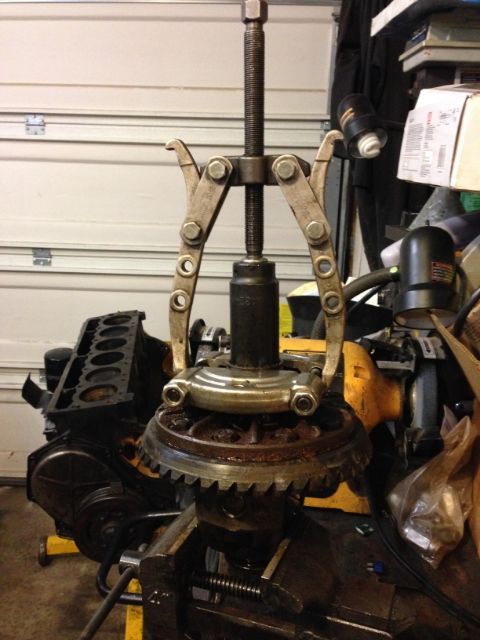

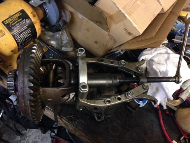

Specialty tools? SPECIALTY TOOLS?!? We don't need no stinkin' specialty tools!!!
I figured out a way to pull the carrier bearings with a cheap bearing splitter and a two jaw gear puller and a socket. So I WILL be using new bearings. Yay.
Driver's side:
Passenger side:
That little 4 inch vise is critical. There is no way I could hold this assembly still with one hand and exert the leverage needed to pull the inner bearing race with the other hand. Bend or cut the bearing cage away, let the rollers fall away, place the bearing splitter on the upper lip of the inner bearing race, use a socket that is smaller than the bearing race inner diameter but larger than the hole in the housing (a 32mm socket worked perfect for me), and use the two jaw gear puller to pull the inner race off the differential.
With a little luck and hard work I should get this project finished up this weekend. Huzzah.
