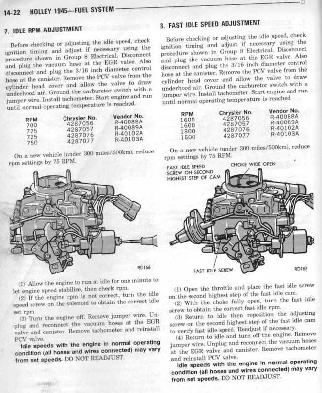

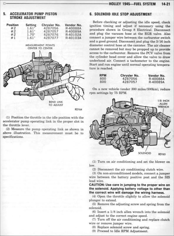

PostPosted: Sun Jan 25, 2015 8:18 am
Posts: 13367
Click on the pictures, they get bigger. Actually, right cick or control-click and open the image in a new tab. Then you can download or print them bigger.
Lean burn component locations (this is for an air cleaner mounted computer. Everything is the same on your truck except the computer is by the battery, s the ten and twelve way connectors are over there):
Carburetor vacuum line hookups (ESA tube is the hose that goes to the lean burn computer):
Carburetor adjustments:
The following wiring diagrams have the entire lean-burn system highlighted in orange. You will see that it is actually a separate harness that can be fully removed by cutting only a few wires at factory splices. I wrote in blue pen which wires to cut and where.
