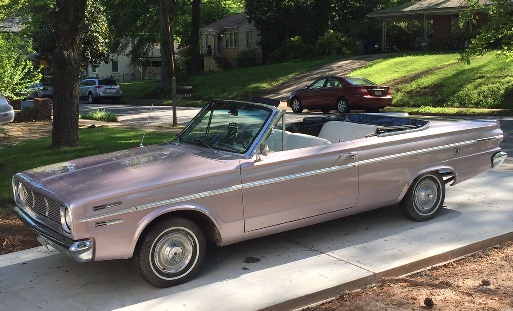

Last summer I bought a 1966 Dodge Dart 270 Convertible...225 Slant 6 with 727 Torqueflite transmission (whew! That's a mouthful!) It runs great except for the pesky transmission leak at the speedometer cable...which needs to be replaced. I've been told it's an "early" 1966 Torqueflite and has the "odd-ball" push-in style connector...which is where I'm having a problem...I've ordered several from parts dealers, classic car salvage, etc...but none fit. I've been told by a friend-of-a-friend mopar guy that an adaptor may be available to connect original to newer version...

No adaptor is needed or available. What you need is the correct cable. What that means depends on exactly what you have. Show us some pics of your car, and some pics of the cables you have tried without success to install.

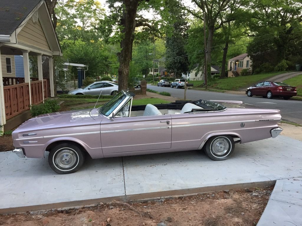

From the side, it sure looks like a '66.
Pics of the speedo cables you bought but can't install (at the transmission end) will help a lot.

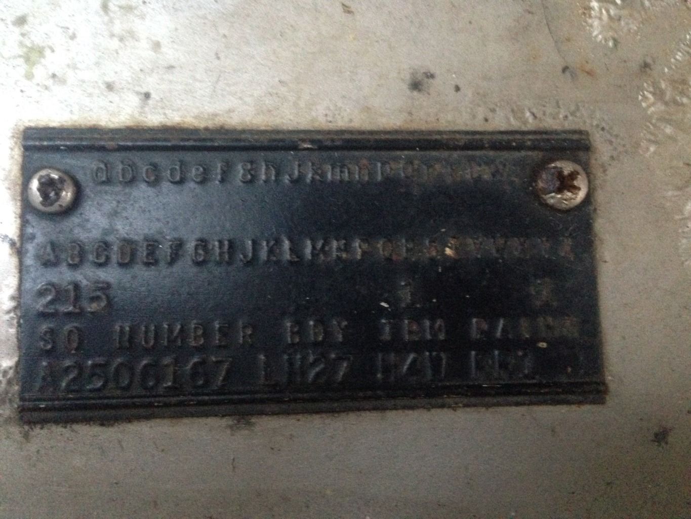

All the stuff I've done so far has been with 66 parts... The engraved plate decodes to a 66...

Good, it's a '66. Show us the speedometer cables you've bought that you haven't been able to install.

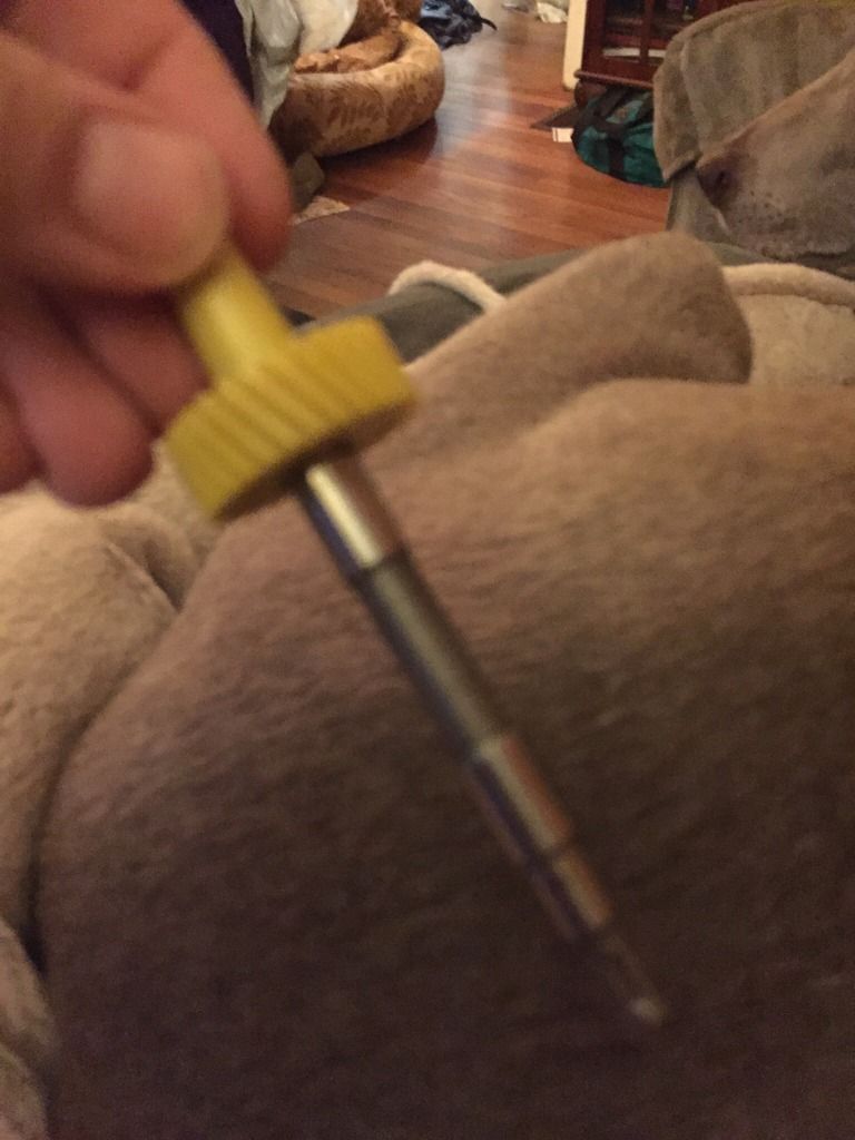

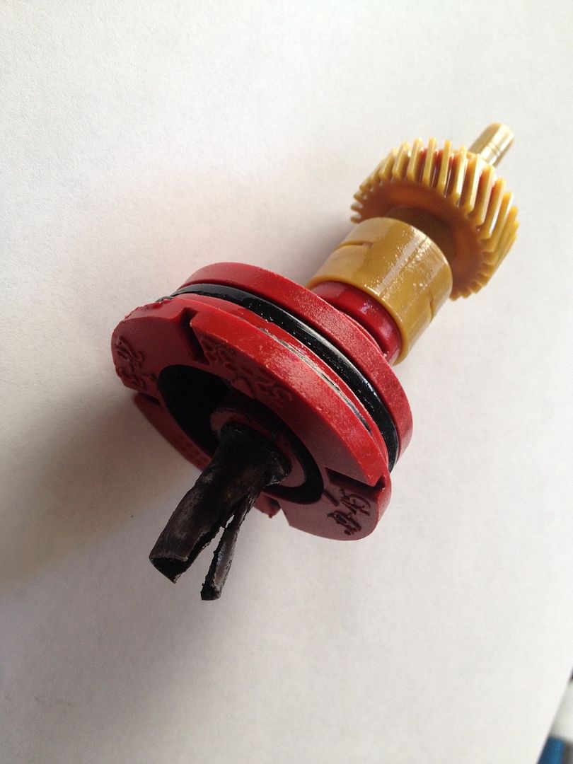

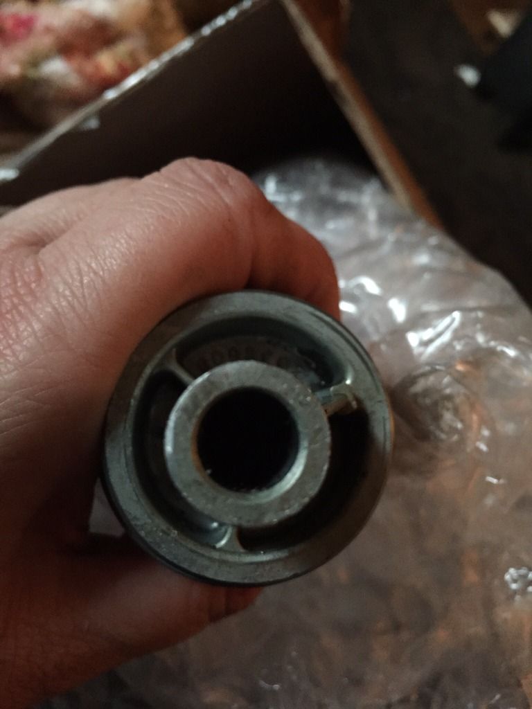

Sorry so long to respond...here's the winning cable and pin... Fingers crossed!
Here's the winner...30-pin
Here's where it connects
Here's the original pin...
Here's a pic of the new paint...Iridescent Lilac/Mauve 😎

Errr...nice pics, but none of them shows a cable. You show a yellow speedometer drive pinion which it sounds like you've counted or read to have 30 teeth, and you show a red speedometer pinion adaptor (looks like made of plastic...? Original would have been metal), and you show what looks like a metal speedometer pinion adaptor being held in hand...but there's no cable here.
The correct tooth count on the drive pinion depends on tire size and rear axle ratio. Did you do the lookup to figure out that your car's tires and rear axle ratio call for the pinion you've chosen?

The cable is attached to the other end of the metal in the second pic...the metal thing with the cable and drive pin are "new" and replace the red plastic...once the rain stops I'll take it over to my car guy... Now that we found a new pin, we think we have all the pieces...stay tuned!

That red plastic pinion adapter reminds me of the later ones - maybe from a Volare/Aspen as does the pinion gear.

Beautiful Car! Great Color Choice! 1966 is my 2nd favorite body style! :D
