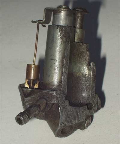

To set the step-up piston spring I have an old carb. body with a hose fitting attached.
With the spring & piston installed, I "T" in my vacuum gauge and draw a vacuum. I find the point where the spring / piston overcome the vacuum, as indicated on the guage.
To set a different enrichment point, change or adjust the spring tension.

Yes, I actually have a piece of an old carb. which I made into a step-up spring tester. I will take a photo of it to post.
I get the vacuum either off the engine or from a vacuum pump.
For a stock SL6 the step-up rods should start to pull out of the main jets at about 10 inches of vacuum.

Here is a photo of the step-up spring adjustment fixture, it is a section of a carburetor with a hose bib epoxyed-in. I take a long section of hose and connect it to where the choke pull-off hose connects to the carb. I route the hose into the car and I can watch how the spring / step-up rod reacts to throttle. You will see that I also have a section cut from the floor jet so I can see how the rod fills the floor jet opening.
Once I have all the parts set correctly, I open-up the carb and install the combination of parts into it.
It is kind of a cool tool because it let's you see what is going-on inside your carb.

That's very cool and simple way to check springs. My problem is that I don't have spare carbs for parts and I don't know where to buy different springs.
That tool you have made is from older type of bbd. Are those springs similar than newer carters?
