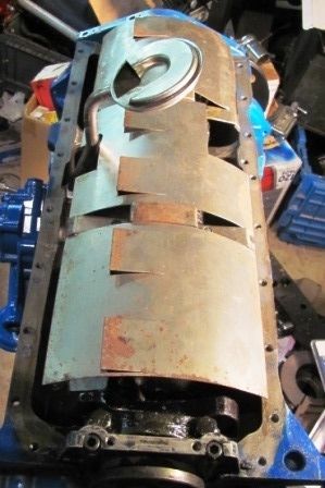

Referencing this pic:
The small square hole in the center is to clear the oil pickup tube.
What is the large square hole for?
PostPosted: Thu May 05, 2016 12:14 pm
Posts: 1455
I guess, the next question is, did I put the dang thing on correctly?
I am assuming a clockwise engine rotation (looking at the engine from the front).
PostPosted: Thu May 05, 2016 12:37 pm
Posts: 14862
One hole is the pickup, other is for dipstick.
PostPosted: Fri May 06, 2016 12:15 pm
Posts: 1455
Does the engine rotate clockwise when looking at it from the front?
I am fairly certain it does, but it's just something I never paid enough attention to.
PostPosted: Fri May 06, 2016 1:01 pm
Yes. That's why it unloads the right rear tire.
