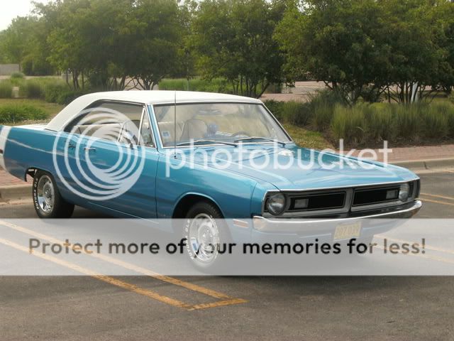

This is the car and the motor.
At the present time all I have is a Offy Dual Carb manifold and a nice powder coated early valve cover and a spare motor. I want to put the new motor in over the off season but want more pep without losing the reliability. What I was thinking was to get a couple of nice Holley 1 Barrel carbs, make up some linkage and get a Lokar Kickdown cable, A set of Clifford Hedders, a Pertronix kit, and throw all of it together and put the motor in the car. Im looking for more show than go and reliability with a little extra pep from the motor and a little more bling under the hood running a different setup than most others. All of this without doing internal engine work. Am I going the right way with this idea. If so what would be the best carbs to use and has anybody crafted a linkage setup that I can copy on my car? I guess putting an ad on this site would net me some stuff for this? Thanks in advence for the help.

The key will be finding a decent pair of carbs that aren't total crappola Chaz. The rest of it will be fairly simple bolt together stuff. I can help you fab up linkage if you need anything. :D

If you want to dress things up, chrome accessories for the slant six are somewhat limited. That just means you have to get creative. Lots of cleaning, painting, and polishing.
The key will be making it reliable and fun to drive, that will make the dress up part more rewarding.
Best single thing to do to the engine would be to bump the compression up to the 9:1 area. You will need to measure what you have first and then get the head shaved. More compression makes a world of difference.
