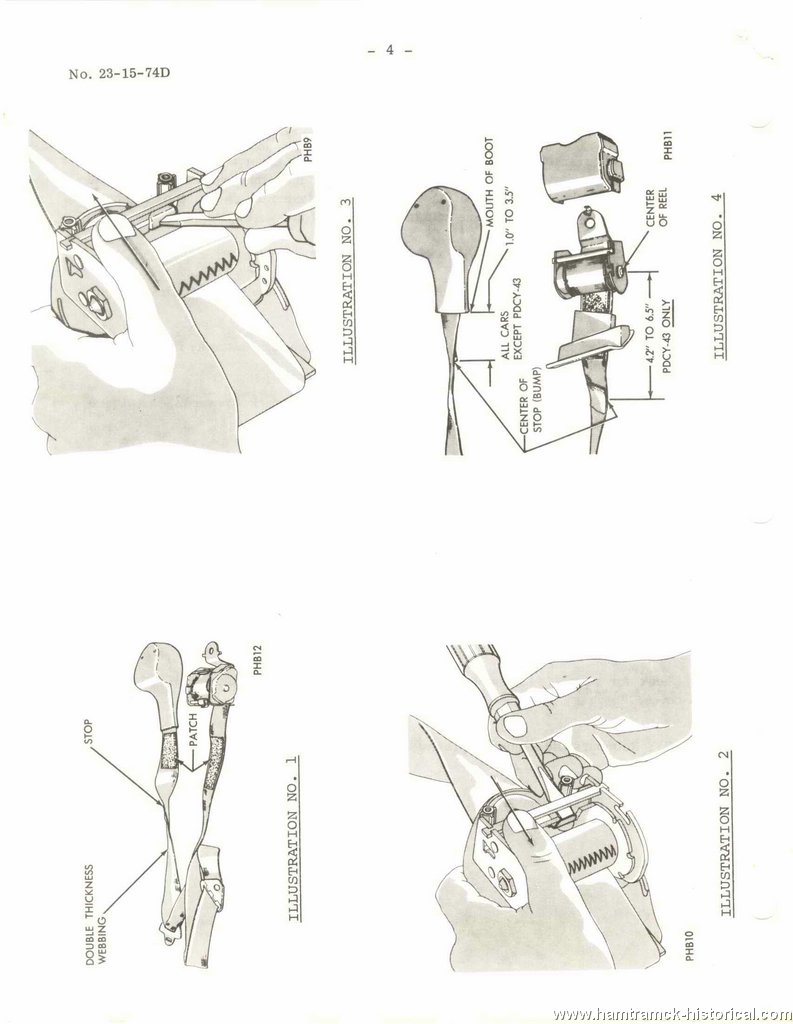

If memory serves me there was a TSB published by mopar that addressed this. I don't remember it with certainty but I believe it illustrated how to take them apart and make the necessary adjustments .
PostPosted: Tue Nov 29, 2016 10:51 pm
TSB Page 1 · Page 2 · Page 3 · Page 4
