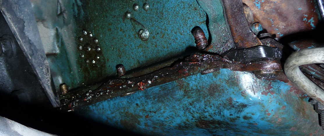

The lower rail pan gasket is bulging out at both ends and along its run in one place. Here’s a view of the front end, before i started messing with anything:

So yesterday i did the dance of getting new oil + filter, fresh new 95g tube of Permatex 82180 Ultra Black, etc. for the job. Drained out the oil + removed the filter as usual with the engine nice and warm. Gave it hours to drain, then went back to start cleaning out the gap, knowing from the wisdom here and many other places that RTV isn’t going to adhere well (or at all) to oily surfaces.
Here’s where i may have really screwed up. It’s always looked to me like there was nothing other than RTV in that gap, which would not even slightly surprise me given what the previous owner did or allowed to be done and the decades i’ve spent undoing the corner-cutting. So i dug and i dug and for awhile all seemed good until i pulled out a big piece and looked carefully: cork (or similar) gasket, that i just wholesale tore off. Here’s what i dug out before i stopped (Ultra Black package corner shown for scale; apologies for the poor focus):
I stopped digging but kept solvent cleaning, using cotton swabs to get as deep into the gaps as possible, all the way along that lower rail and as much as i could near the corners with the end rubber gaskets in place. Took a long time and a lot of swabs, but eventually it was as clean as humanly possible. Getting dark, so gave it overnight for every trace of solvent to evaporate.
This morning i came out to set up to apply the Ultra Black, and to my great dismay found a line of oil pretty much all the way along that edge. How long does it take for these engines to finish draining down, so that edge will stay clean? Wiped down the edge again with a shop towel (one of those blue paper tear-off roll kind), then mostly as an exercise in futility, i used a shop vac crevice nozzle to suck out what i could, which seemed to do very little. Unsure how to proceed, i stuffed clean blue paper shop towel edges as far in as i could along the whole length (other than where the old chisel is holding the gap open). Very little to show for it after half an hour:
It’s now several hours later and i just went and looked again, and it looks exactly as in the photo. Would have thought that the towels would wick out whatever oil is still draining down and passing by and/or sitting there inside.
How does a mere mortal get that edge to stay clean and dry long enough to properly apply something like Ultra Black and have it cure and adhere properly?

If the leak is only on the side of the pan, not on the front where the timing chain cover is or on the back where the molded rubber gasket goes around the rear seal, it looks like you have enough room to slide an original gasket in.
The oil pan gasket comes in four parts, with each side just flat and simple. SO get both sides cleared up, slide in the new gasket, and you won't need any sealer at all.
This is all contingent on having enough gap between pan and block and being able to scrape a clean surface for both w/o any of the old gasket ending up in the oil pan, of course.
Hope this helps and good luck.
