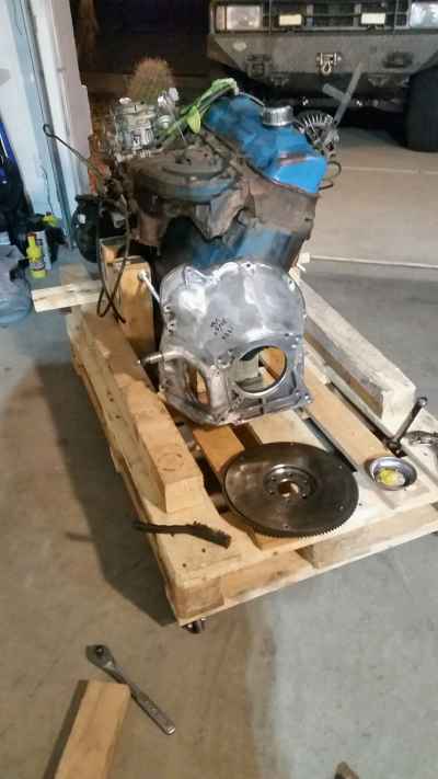

I think I am using "engine" and "crank" interchangeably". The holes line up just fine, but I will need some longer bolts. Why do I need the bell housing on the motor to test the engine? I just want to run it for maybe one minute on my stand to ensure there isn't anything catastrophically wrong with it. I need to order a starter and some spark plugs, then should be good to go.
how do you plan to mount the starter?

PostPosted: Tue Dec 24, 2019 1:51 pm
x2, and how about securing the rear of the engine so it doesn't wobble and tear up your
Fir motor mounts.

Dadtruck: it looks like the starter is supposed to mount onto the engine with the teeth covered by the bellhousing. I need to get that service manual. That said, I'd be grateful to take you up on your offer unless there is a reason why the other starter would be benificial. How can I send you money for shipping?
Dusteridiot: I'll have you know that's the highest quality structural pine that my compay can get for the cheapest price. But yes, I will take your advice and find some way to strap it down. It was minorly terrifying levering it off the engine hoist with a pipe while trying not to drop the whole thing 4 inches. Next, looks like the NKG plugs are only 2ish dollars. Do more expensive plugs really make a difference? Finally, why should I go with those bolts vs going to ACE hardware? Better temper?
