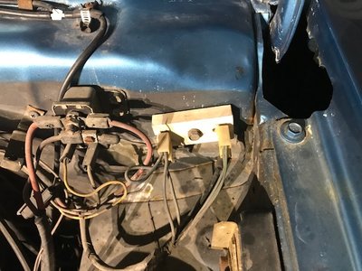

But I notice the ballast resistor has 2 terminals on each side.
Do both get hooked together?
Thanks

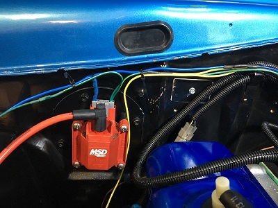

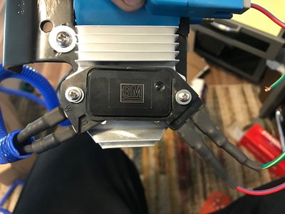

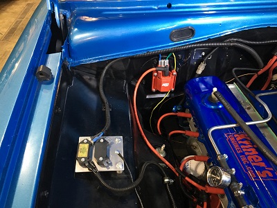

Here is mine on my race car.
Blue wire comes from the +12V from your old ballast resistor or 12 Volt source. This hooks up to the original red wire on the coil plug. I soldered a second wire on the that terminal and ran it on over to the HEI module. Then the Green wires. One runs back into my Tachometer and the other goes to the HEI module. Ignore the yellow wires they are just for the low oil pressure cutoff which you don't have. Hope that helps.
Rick

 Post subject: Re: HEI retrofit help
PostPosted: Wed Dec 27, 2017 4:46 am
Posts: 9092
Easiest way on the ballast resistor is just tie all four together.
