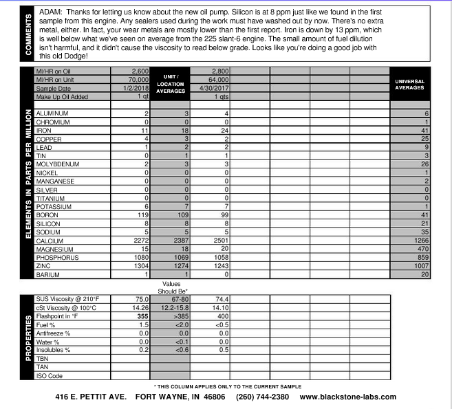

Hello, everyone. Just wanted to post my second UOA of my '85 Ram here for you guys. 2,600 mile interval. Did this UOA just to see if my wear rates have gotten better and they did. Engine looks like it's really solid. Probably going to extend the intervals up to 4-5k at some point.

Each sample you send in to Blackstone for analysis is $28. I usually send one in maybe twice a year. It's a good investment in my opinion to get a look at how good of shape the engine is in, etc. If anything starts to fail mechanically, this test will find it before it completely fails.
