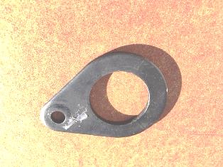

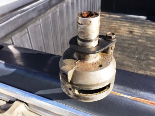

If it is a post 79 engine, it likely needs this hold down plate.

There's definitely a place to bolt something to the bottom of the distributor on the fire wall side. I think you guys have nailed it! All I need is the hold down ring! Thanks so much guys! This whole project is a learning experience. I've done ford 300 in line but never the slant 6 before and it seems that whatever the previous owner touched is done very poorly.
