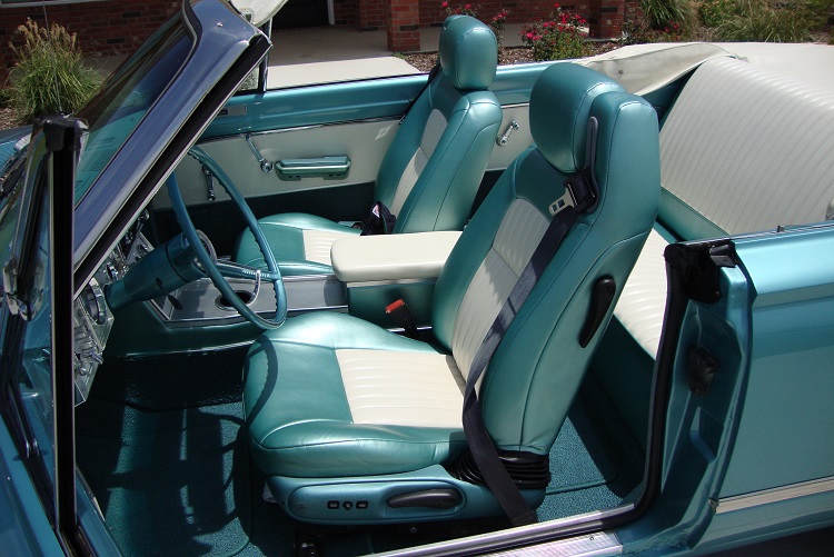

I have '99 Sebring seats in my '64 Valiant and love them. They were relatively simple to install and wire. The only issue I had was understanding the belt release function, as there were so few swaps at the time, and I had no one's brains to pick.
