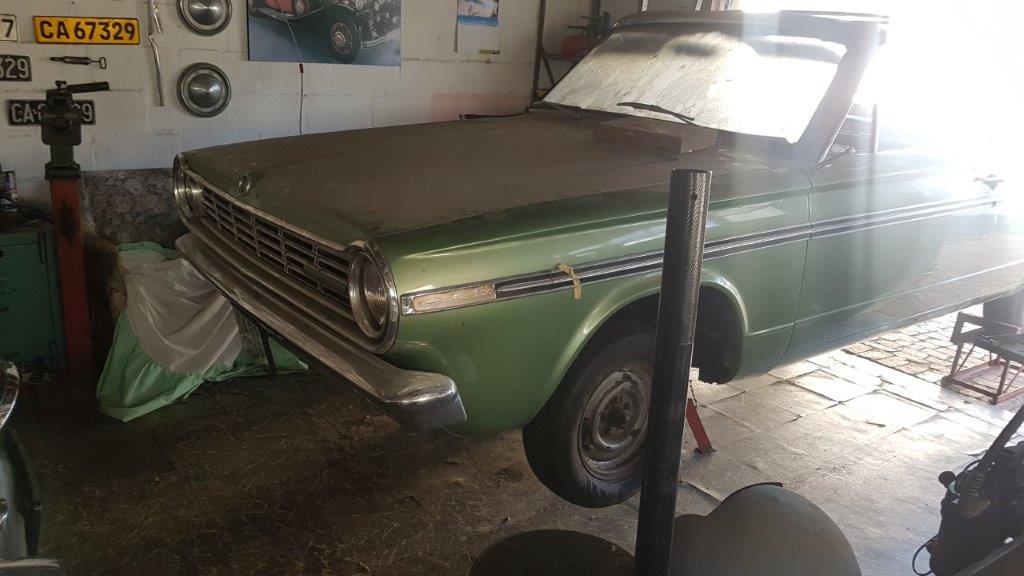

Hi All,
I bought this Valiant with the Gearbox and Starter Missing. I found a gearbox, made the linkages. (I were quite chuffed how quickly I found a Box as Most Valiants were fitted with Auto Box in South Africa).
After Battling to fit the starter from my Auto 65 Dodge Dart I found out this car has a 148 tooth ring gear and needs a 9 tooth starter. From my research it appears this should be a Bosch Starter.
Finding a 9 tooth starter locally will be difficult and were wondering if one could swap the 10 tooth Bendix from the Chrysler Reduction Starter with a 9 tooth from something local.
1) Google tells me it should be a 9 tooth 25mm gear. Is this Correct? I see a lot of Euro Cars are fitted with a 9 tooth 25mm Gear.
2) Has anybody here converted a 10 tooth to a 9 tooth and from what car was the gear/bendix from.
3) Is there and alternative starter that can be used maybe modifying the mounting bolts.
4) Or... Can the 148 Ring Gear on the Flywheel be swapped with a 122 Torque Converter Ring Gear.
Thanks for the Help.
