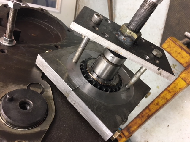

I opted for one of the fancy Rollmaster double row timing chains....it's a nice quality part.
But, IMO, they make the lower gear a tad on the tight side. With most gearsets, you can slide the lower gear over the crank with a 'little' effort, and you can remove it the same way. With the Rollmaster, there was no way the gear would come off without some serious effort. I think the average person would 'never' get the gear off without damaging it, or the crank, or both.
Normally, you could hone the ID of the gear a bit but with all the keyways cut into it, I'd be concerned that you'd end up with a gear that was no longer running true.

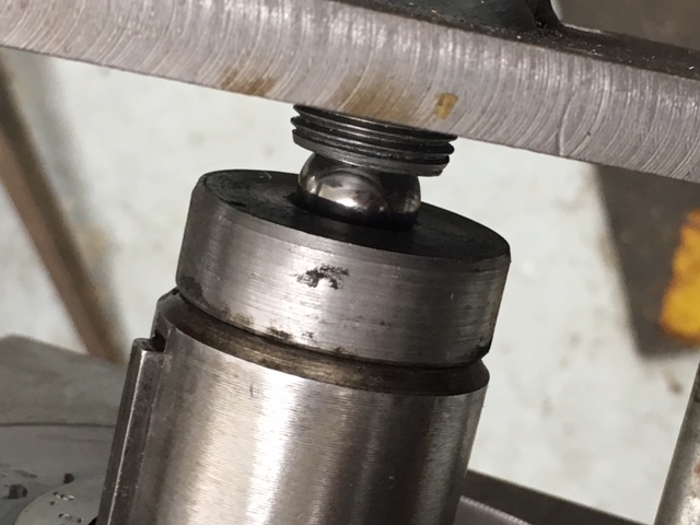

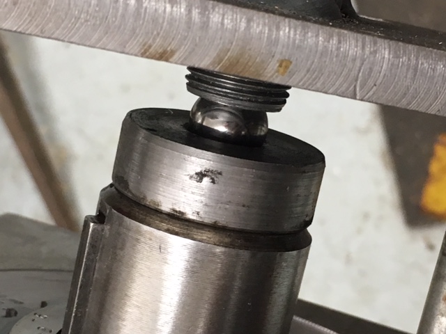

Anyway, I dragged out the puller I made ...half of which is actually half my Dana 80 differential yoke puller and the other half of which is made just for lower gears. This puller registers on the flat back side of the gear and does not touch the teeth...so you won't damage the integrity of the gear. I also included a photo of the thrust plate and ball bearing I use between the crank and puller screw to make it easy to turn, and to prevent damage to the crank. With this setup, the gear comes off with no concern, and fast. But I still don't like how tight the fit is!

Yes, they are VERY hard to get off. I never use the keyways for timing adjustment, but drill out the cam gear to 3/8" and use bushings, for this reason. I have a Craftsman ratcheting 3-jaw puller (6 ton?) that works well for this too. $80 and worth every penny.

We have a lot of hard to get off bearings on machines at work. We have those split plates and it makes the job 100 times easier, especially when it is a part that fits in the arbor press. :mrgreen:

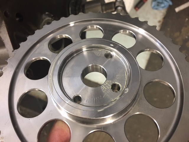

On the topic of the RollMaster chain....I hadn't noticed until today that they have a spiral oiling groove on the back side of the cam gear. Nice touch.
