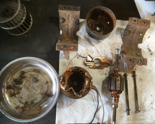

OK. The motor is fully disassembled and soaking. Turns out the jug of environmentally-friendly deruster I had is Metal Rescue, not Evaporust. I bought it in 2012 so my memory was foggy. But they appear to be very similar products, so I am forging ahead. It is supposed to soak at room temp (68 F or higher) for a couple hours, but my garage is about 50 degrees during the day so I will leave the parts in there for a few days.
Here is a picture of the disasembled motor. I tested for resistance and continuity across all the bars of the armature (I hope I am getting the terminology right) and I believe I tested correctly. Testing the commutator bars 180 degrees apart revealed 0.2 ohms on every pair. None of the commutator bars was shorted to the armature. I tested the windings in the housing and none shorted to ground, or to each other, and all showed different resistance readings. I think this means all the windings are OK, the unit just needs to get derusted, lubed, and reassembled. Fingers crossed! Once the parts come out of the bath I will rinse, blow dry, and then cook in the oven for a bit to dry out the windings.
Interestingly, there are no permanent magnets in the motor. It appears the magnetic fields are created by exciting the windings. Of course, I haven't taken any electronics course since high school, and that was 23 years ago now. I vaguely remember something about Mr. Ohm liking square pie, but that's about it. I think I have messed up my old mnemonics.

PostPosted: Wed Mar 28, 2018 1:43 pm
Most small motors like this don't have permanent magnets (or at least didn't back then; maybe some of them are PM type motors now).

I suspect that the "balls" in each end of the housing are the bearings. they are called (among other things) sleve bearings and often were sintered metal with lubricant forced into the voids. Common on small motors, including many starter motors.
Thanks for the info! Any lubricant that was there has long since dried out. I was planning on some dabs of wheel bearing grease unless anyone has a better suggestion.
Wheel bearing grease is much too heavy/stiff for this application. Isolate those sleeve bearings to the maximum possible degree, assess their state of wear (should be very, very, very minimal sideplay with the shaft installed) and if that's the case, drop the bearings in hot synthetic motor oil for awhile, 5w30 is fine, then remove the pot from the heat and let the oil and bearings cool down together to draw oil into the pores of the bearing. Then wipe up and reassemble.
