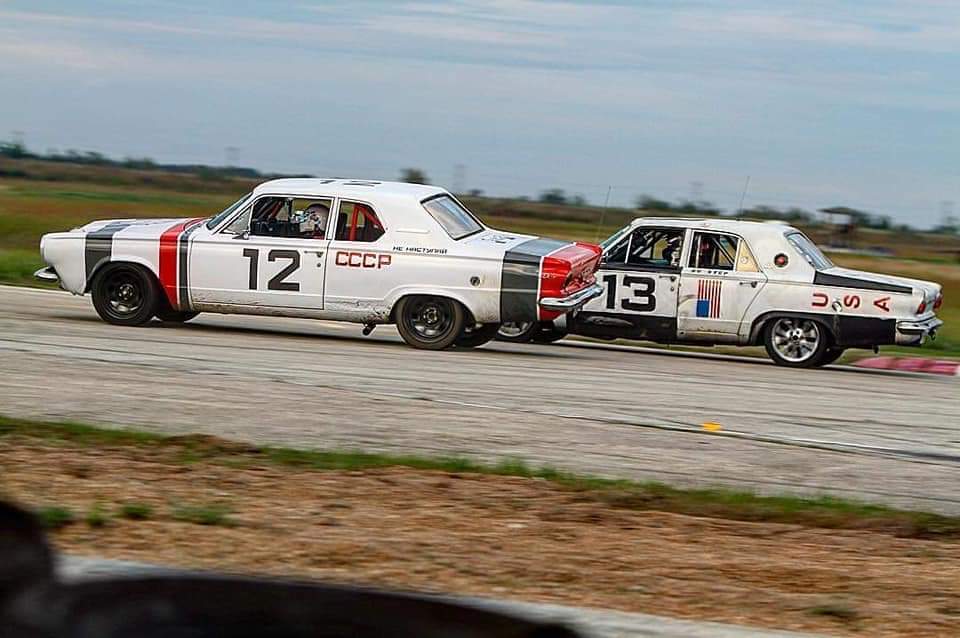

We knew we wouldn't be very competitive with a stock engine, so we weren't too bothered by all this. We were able to succeed in our one goal for the car, which was to beat some of our friendly rivals from Austin called "The Resistance." They normally race older Hondas, and did bring their 70-something Civic Wagon to this race, but they also showed up with a huge surprise for us... a '63 Dart 2-door they'd been working on in secret for over a year, with a Soviet space program theme to match our NASA-themed '64 Dart.

The judges put us back in Class C (the slow class) so we could compete head to head, but they gave our well-seasoned racecar a 20-lap deficit to make up. Even with the issues we had, we made that up pretty easily. Our friends stayed on track most of the race, but they had typical new-car teething problems and were significantly slower with a 1-barrel carb and stock suspension. Anyway, it was a lot of fun "beating the Commies back to the Moon," and it meant a lot to my team that they went through so much effort to parody us. There were a number of little details in the car (like copying our gratuitous "NO STEP" stencils but in Russian), and a few of their team members actually went out of their way to dress like me and Bob. It was awesome. We took home the challenge trophy they put together out of random slant six and Dart parts, and they won the "Judge's Choice" trophy for their car.
