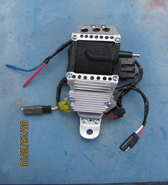

Here is the finished item on my Race Car. I tried to keep it light and compact (and simple).
This is everything, there is even a power relay in there somewhere.
The pigtail that goes to the distributor is a trailer plug, the other two (to the module)are as listed in the above post. I put a piece of red tape on one side of the module power plug to (hopefully) make it harder to plug in backwards. The coil connector came with the coil, but I think it is available separately (Ford application). The only external connections are a blue wire, which goes to the factory ignition power wire (also blue). There is a red wire for power (+12v) applied via the relay. And, lastly, there is a yellow wire for the electric tach (it's yellow only because that was the color it happened to be). I also have a separate ground wire for the entire thing. It isn't really needed, but I feel better with it there.
-Matt

Author:  Badvert65 [ Sat May 26, 2018 8:53 am ]
Post subject:  Re: HEI MODULE CONNECTOR!
Yes, I made up my own mounting bracket. I like things simple, compact, and light (on the race car).
I got a 'heat sink' with the Ford style coil, but I didn't use it. I didn't think the coil needed a heat sink. I just bought some generic heat sink plates on ebay for the module. The one on top of the module is more for looks, but there is one on the bottom as well. I plan to make a second ignition assembly, to have ready at the track as a spare, in case of problems. The harness for this thing is small and wrapped in harness wrap (like tape, but not sticky). For the race car, I am using an Accel coil and module, but my spare will likely have the regular OEM stuff I picked up to build the 'prototype'.
And, as an added (race car) bonus, the HEI setup is about a half pound lighter than the OE Mopar module/coil.
-Matt

Author:  Badvert65 [ Mon May 28, 2018 8:20 am ]
I just used a Standard RY116 relay. There are easy to find, under various part numbers. Some auto parts houses even have the connector plug for them. I like this relay because it handles high current and is designed to be energized for lengthy periods of time. I use the same relay for my electric fans.
-Matt
Author:  ih61guy [ Mon May 28, 2018 9:20 am ]
Matt,
What do you do with 5th terminal?
Think marked 87a.
Rod
Author:  Badvert65 [ Mon May 28, 2018 4:10 pm ]
Terminal 87a just hangs there, nothing connected to it.
85-harness ground
86-car harness 'Start/Run'
87-power for ignition module
30-battery power in
-Matt
