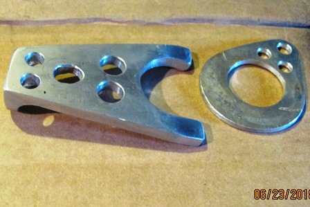

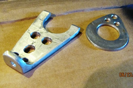

These things don't have to be made from steel. I made my claw from a piece of 1/4" thick aluminum 'L' stock. I made the distributor plate from 1/8" aluminum plate. My 'machine shop' consist of a drill press and assorted sanders/grinders.
My distributor plate is odd shaped (compared to the original) because I (unintentionally) made the fingers of my claw a little wider that the original claw. This should be a relatively easy piece to make with proper equipment.
jus' sayin'
