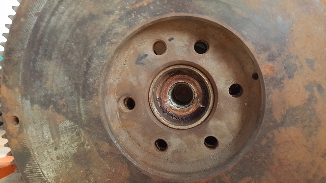

If one hole is off by about 1/2 the diameter of one bolt you have a 273 flywheel. The early V8 A-bodies (and maybe others) used a 122 tooth flywheel and a 10" clutch.

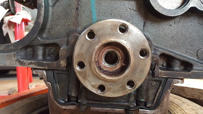

Okay here are the pics, could be a 273 flywheel, but is not a slant 6 flywheel.
Is it wise to drill out the 6th hole and use it as is?
