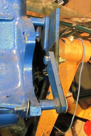

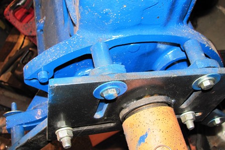

PostPosted: Thu Sep 06, 2018 7:31 am
Posts: 1450
I mount my slants to the stand in a slightly odd way, but it gets the center of gravity lower.
If you look closely, I flopped the top arms around and bolted the top two engine bolts directly to the engine stand head.
I am just using the arm as a spacer. The lower two arms mount in the usual way.
I haven't run into any problems with the engine mounted this way. It just lowers the entire assembly so it doesn't feel quite so top heavy.
