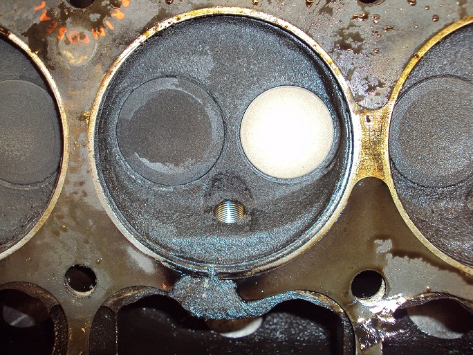

After getting some horrendous results on my leak down test, I finally pulled the head off my 225 /6 motor. As I suspected, blown head gasket in #4 hole. Also the valves seats were in really bad shape. Whom ever did the last valve job, didn't know what they were doing, as the valve seats were all over the place - some sunk, some seats almost off the valve face, some valves with almost no margin left on them. Heads gonna need new seats, valves, springs, and guides. On the plus side, no grooving on the block from the blown gasket. Gonna pull .090" off the head surface and bolt it back on. Might do some minor bowl porting. Cylinder bores are stock and the taper measures in the .015 to .022" range.

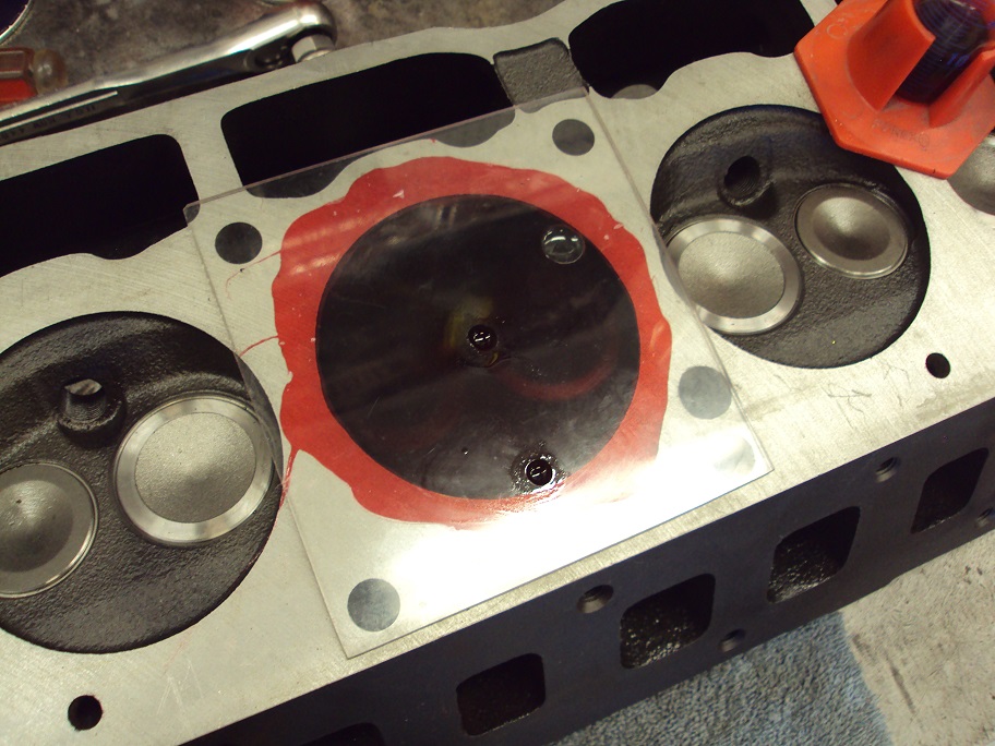

Soooo, Got my head back from my machinist - new stock valves ( back cut @ 25* ), springs, guides, seals and head milled .090". Combustion chambers CC,ed at 48CC's. With stock bore / stroke, .042" compressed gasket thickness, pistons .163" down the hole, I ended up with 8.79:1 CR. I did not run the numbers with stock combustion chambers ( wouldn't hold fluid ), but the CR had to be ridiculously low.

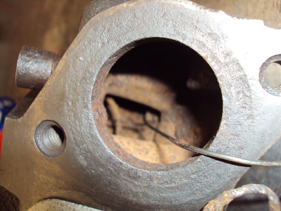

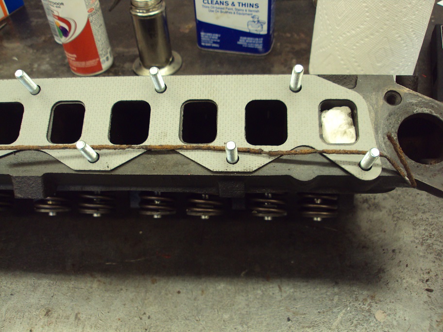

On another note, check out the attached pics. While looking in to the thermostat housing hole I found two lengths of wire in the water jacket. The one I removed ( laying on the head in one pic) came out of the water jacket on the port side of the comb chambers. The other wire is still in the head ( other pic ) and it is on the lifter side of the chambers. Just started to fish it out in that pic. ????????????????? I have no clue as to how they got in there or why.

The wires are part of the casting process. Once casting is complete, the sand is removed, but the wire that holds the sand during the pour remain in place.
