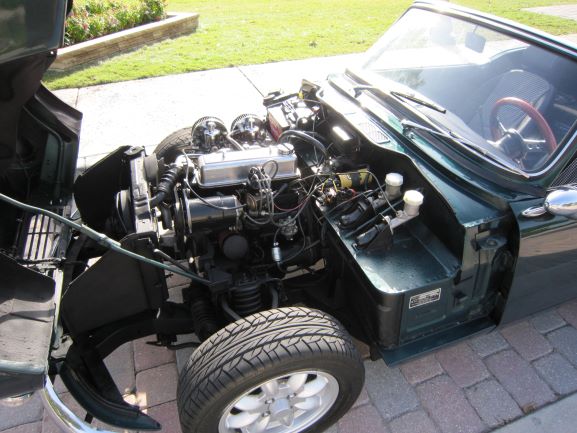

Perusing previous posts... Dan (or anyone else) complete a dual SU carb setup? Looks like Redline in Aussie just has the triple intake. I'm familiar with working on them since my Dad owned umpteen volvos and I owned a 66 spitfire with duals that I sold last year. They're neat (especially polished) and found them easy to work on and sync.
Tony

Yup, I've got that intake, in nice shape and for sale. Might have linkage parts, might have buildable carbs, but definitely have the intake.

What SU's had your research revealed? Looks like twin HS4's would be okay for stock /6 - appears cfm's would max out at around 4k rpm. However, the HS6's make more sense for future enhancements...
