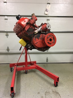

I just gotta tell you about my new engine. I call it "Project Sandman". It's named for the project's benefactor, 64 Convert.
It's a 1964 225 with a forged crank, drool tube head, etc. I began tearing it down soon after getting it home. Along the way measurements were taken to calculate the static compression ratio. The pistons are .168 down the hole, combustion chambers are 61cc (dime spot casting). Using these numbers the SCR is 7.68:1.
The plan is to build it for street performance with shaved deck, cam regrind, oversized valves, and basic clean up on the head. I'll swap in my recurved distributor, HEI, custom two barrel intake and free-flowing 2.25" exhaust. I'll add a Dutra Dual with a modified rear manifold at some point.

It looks so much better sitting on a stand waiting to come to life again. I'm really glad it went to someone who wants to do that!
