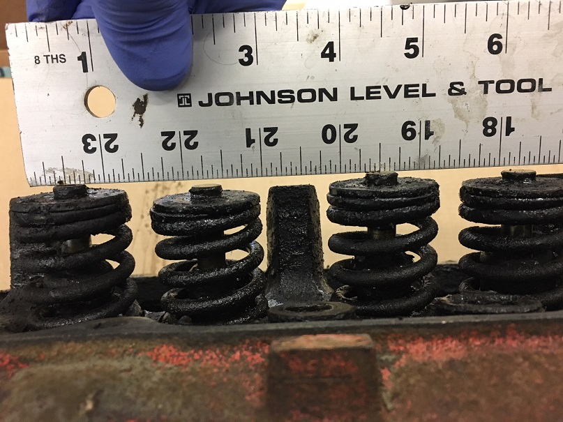

I pulled the valve cover off the 225 and laid a straight edge across the vale tips....and I knew there were gonna be issues.

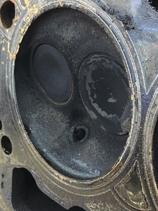

So when I pulled the head I could see the face of the exhaust valve was actually a little below the combustion chamber surface.

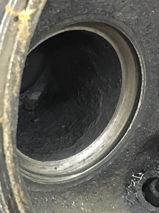

Removed the valve and the seat is gone! It's hard to tell from the pic but the valve was pretty much smushing itself a new seat as time went on. The valve guides were also pretty sloppy. The valves themselves looks pretty good.
I don't know much about the history of this car but I can tell you it's a 132,000 mile engine, never been apart before, and spent all of its life as a daily driver in CA. I know there's a raging debate on hardened seats but for this head....either it gets new seats or the junk bin.
