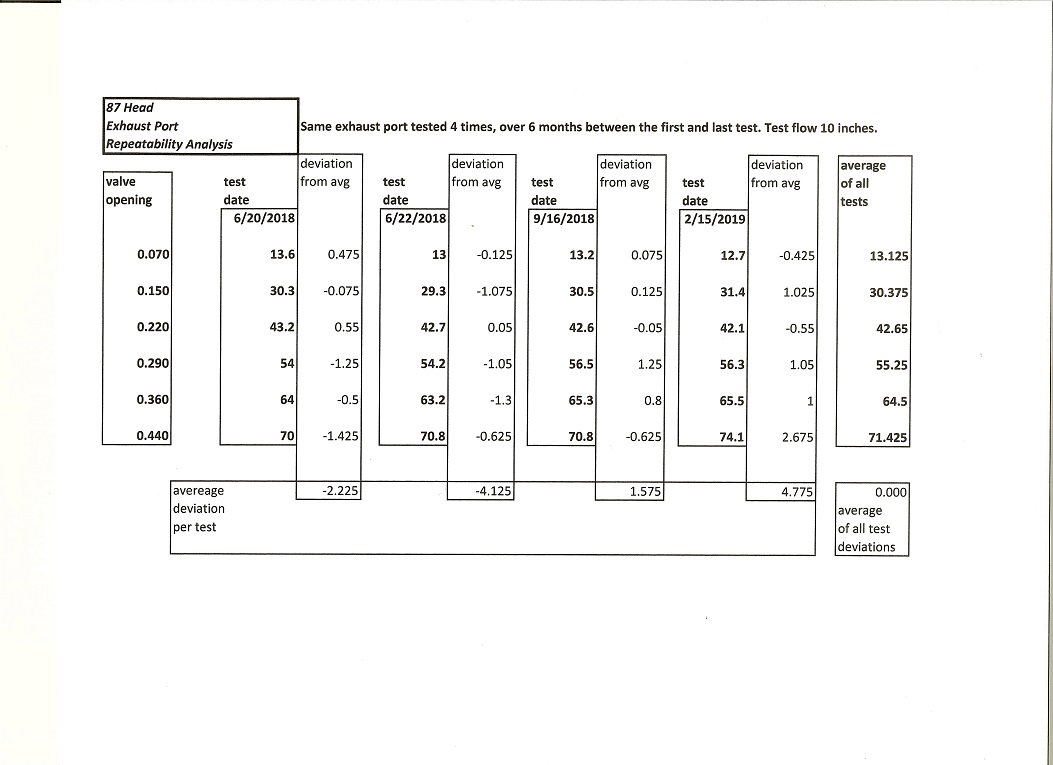

over the past few months a former engineering co worker and I have invested some time and a few dollars in
working to get a slant head that at least matches what Mike J had produced. Mike was good enough to send his
data sheets along with the hard test equipment, so there is some evidence of what he was getting, concerning port flow.
I did not get the actual valve seat and port tooling. It is one thing to talk about what one was doing, and it is something else to
reproduce it.
There has been progress made, after a stumble, the last test gets what Mike J did with the same sized valve.
There are two files attached, the first one is a capability-repeatability study of the machine, the SuperFlow 110 and the operator, me
To do the flow improvements, I have been using the same peanut 87 hydraulic head. The exhaust ports were cleaned up, 45 degree seats
put in and not touched again. On each iteration of the intake port I re tested the same #3 exhaust port to get a base line on the repeatability
of the setup and the flow results. The system is extremely repeatable. Over four unique tests, from June of 2018 to Feburary of 2019, each with
a complete tear down and a new set up, the test to test variation for a given valve opening was in the worst case 2.6 CFM and was typically less than
1 CFM.

File comment: exhaust port repeatability information
