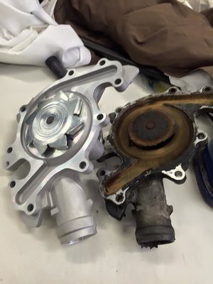

I am sure the stamped fin vanes will be fine. The sad truth is...the cooling circuits and systems of the older engines like the Slant 6 aren't very scientific. I think you could make the vanes out of an aged cheddar and the engine wouldn't know the difference.
Modern engines have had much more development put into them in this regard. Just for fun...a friend had a 2002 Ford minivan with a 3.8L V6. It ran perfectly cool, even in Houston summers which are impossible to describe the miserable heat unless you've lived here. But, one winter the heater stopped working. After the usual troubleshooting, we determined it wasn't working because there was no water flow - and Ford minivan heaters, of course, use flowing hot water. The engine ran fine - just no heater.
So, we endeavoured to replace the water pump and sure enough, the heater worked fine thereafter. As luck would have it, there was in fact no water flow. Don't believe me? Here's the pump:

I think that picture of the Furd pump well illustrates both the folly of sheetmetal impellers and the need for regular cooling system maintenance.

The Ford pump definitely shows the need for cooling system maintenance. The previous owner had run pure garden hose water for years.
