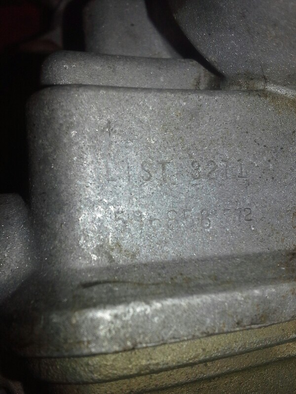

What is the carb number?
PostPosted: Thu Feb 14, 2019 6:43 am
Joined: Mon Feb 11, 2019 9:15 am
Posts: 53
Car Model: 1965 Dodge Dart, 225 Slant Six
3271 ?

Carburetor number
File comment: Carburetor number
PostPosted: Thu Feb 14, 2019 5:23 pm
Posts: 1603
http://www.mymopar.com/index.php?pid=109 3271, 1966 225 manual tranny non cap, cleaner air package The 1966 dodge dart and coronet manual has that carb info and idle set instructions.
