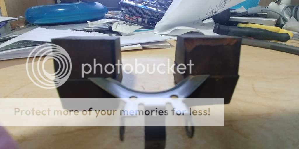

Second the float on the original carb is slightly damaged. Can I swap in the float from the 6280? The original is marked 510 and looks like it is 14.5g whereas the 6280 float is marked 516 and looks to be 14.0g. Besides that they are identical.

Damage in question.

As far as the float goes, if it fits and doesn't sink, I would just set the float level to spec and call it a day.

I figured that the float being within ½g should be OK and yes it does fit.
Better than the damaged one.
