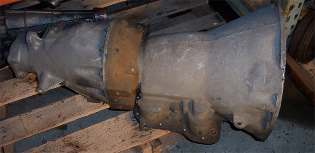

So here's my 'rare and exotic' Torqueflite photo. Anyone know what it is? I can tell you it is an OEM 'factory' arrangement...
