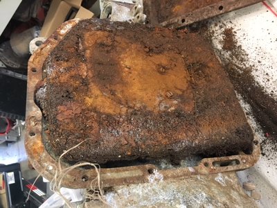

About 25 years ago, or more, I took a slipping 998 out of a 5th Avenue and stored it carefully by leaving it outside in the dirt....
So now that I've driven my 68 Valiant and (of course) the trans is leaking from every possible location, I'm planning to pull it out and go through it with a full rebuild. I'm thinking it would be a good idea to use the 2.74 gearset out of the 998 to help pep up the 225/2.76 combination....
Even though the 998 had a little dirt in the pan (see pic), the gears still look nice and oily.
So my question is....has anyone actually done this, and if so, are there any 'catches' to look out for?

Hmm.. OK thanks guys. Good background. Maybe I'll just stick with stock. Seems a shame I babied that 998 all those years, for nothing!
