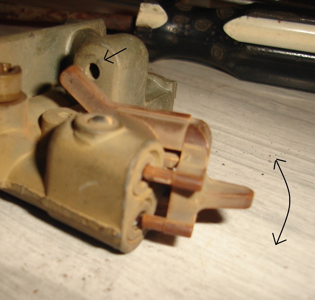

I got my Holley 1920 torn down. The economizer block on my carb. moves side to side. It seems like a lot. It pushes against two check balls below the pivot point and it has an arm that looks like it pushes up on a third.that is above. It looks like it could miss the third check ball due to this movement. Does the pin that holds it in place move? It seems like it isn't all the way in and in the hole on the back side of the block which is allowing the side to side movement. Curved arrows in pictures show direction of movement. Single arrow shows third location actuated by the block. After cleaning should I tap on the to try to get it all the way in?
Also the cap above the check weight was way too small and fell out along with the check weight. Any thoughts on how this would affect operation?

Never mind. This morning I decided &#@% it and went ahead and gently tapped it with a small hammer. The pin moved further in and engaged the hole on the back side. I had to realign it and it snapped into place. It is much tighter now and to movement is more vertical like it is supposed to be.
