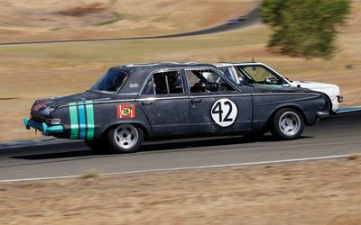

Hi all, my 63 valiant 24 hours of lemons racecar is a original power drum brake car that currently runs later kelsey hayes small bolt pattern drums. It has been converted to the appropriate disk master cylinder and works perfectly!!
However... The power brake systems feel and modulation leaves something to be desired when road racing on track.
What do I need to do to convert the car to manual brakes? I'm guessing I just move the master to the firewall and then need a new rod, but I want to make sure I'm not missing anything.
I already have non power kelsey hayes disks on my 71 valiant street car so I'm happy with how that setup feels.
Anyone have manual brakes and want a power setup? Maybe we could swap parts? I'm in the SF bay area.
Thanks for any input/advice,
-Jon
