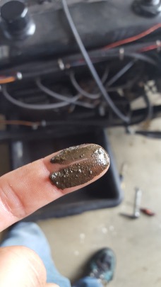

good news I found a way to get the plug out without messing it up. I used a 3/8" drive extension backwards like a socket and put a 3/8" open end wrench on the male side and used a pvc pipe for more leverage.
Bad news...when I took the plug out not a drop of fluid came out. Started going at it with a screwdriver and found this
Even after proving around in there getting a pile of stuff out coolant still won't flow out. So I'm sure its safe to assume this is how the whole block is... what are my options? Do I have to do a complete tear down?

I dont know if this would work, but I would go get an adaptor from garden hose to 3/8 npt, then run the hose into that drain for a while with other hoses or plugs open. if you can get water flowing the opposite way, you can alternate flow back and forth to rinse the crud out. might be worth pulling the freeze plugs if you can access them easily to flush from there as well. you will need new ones if you do.

After more poking with a longer screw driver I was able to get coolant to drain from that plug. I thought about removing the freeze plugs but I would need to pull the intake and exhaust manifold off to reach them so I will wait on that for now. I thought about using an adapter like this https://www.amazon.com/FASPARTS-Female- ... B013XUKUBW to force water into that coolant drain but wondered if it would reach everywhere I need it to. Should I try running the motor with a garden hose going into the inlet hose and direct the outlet hose away from the car while leaving the drain plug out?
...obviously I am going to need to turn the radiator upside down and flush it heavily

Maybe run some radiator flush in there too (follow instructions and don't buy the cheapest stuff)? I think flushing w/garden hose is worth a try, maybe from rad side and drain plug side, and with engine running at different speeds. Hard to say if it will work, but worth a shot.

If you are going to pull the radiator anyway, you might pull the water pump as well.
That will give you at least a little access to the front of the cooling jacket.
Then your reverse flush through the block drain will be able to push crud right out the front.
How about plumbing a small pressure washer straight into that drain port? :twisted:
The common quick connectors are 3/8" thread.
Even though you won't be able to direct the flow, the extra energy in the stream should help dislodge as much as possible without major disassembly.
