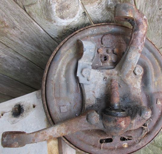

Does anyone have pictures of the spindles for 9 inch brakes, and 10 in brakes, for "A" bodies? I have 9 inch brakes on my 64 Valiant, and am planing on upgrading to 10 inchers. I have several spindles that look different then the 9's, but don't know what they are from. They are very different then the 9's, but are on a 66 or older "K" member. The game plan is to do a complete "bench" rebuild of this "K" member (steering, suspension, and brakes), then swap it out, as the car

IIRC, the 10" spindle takes a bigger bolt than a 9".

Yes, bigger bolts that hold the BJs and bigger hole for the UBJ pin/shaft.

The spindles I have look totally different in the steering knuckle area.

The black one is my 10 inch on the car.
The crusty ones are 9 inch.

Notice how the upper ball joint stud hole is twisted around 90 deg compared to the 10 inch one.
Brian
Yep, that was my concern. Wanted to make sure the ones on the "K" member were correct, before starting to order parts.
