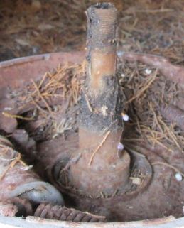

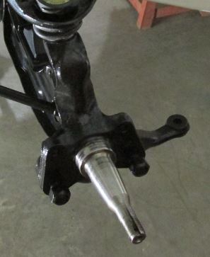

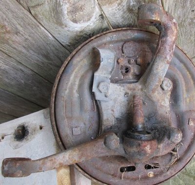

PostPosted: Fri Nov 08, 2019 9:29 am
Posts: 2654
The black one is my 10 inch on the car.
The crusty ones are 9 inch.

Notice how the upper ball joint stud hole is twisted around 90 deg compared to the 10 inch one.
Brian
Yep, that was my concern. Wanted to make sure the ones on the "K" member were correct, before starting to order parts.
