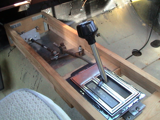

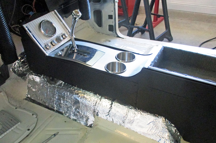

Mopar floor shifters are versatile from one model to another. My '73 D100 has a shifter from a K-car, and the '56 Plymouth with a '66 transmission I'm working on now has a B-body shifter, year unknown.
