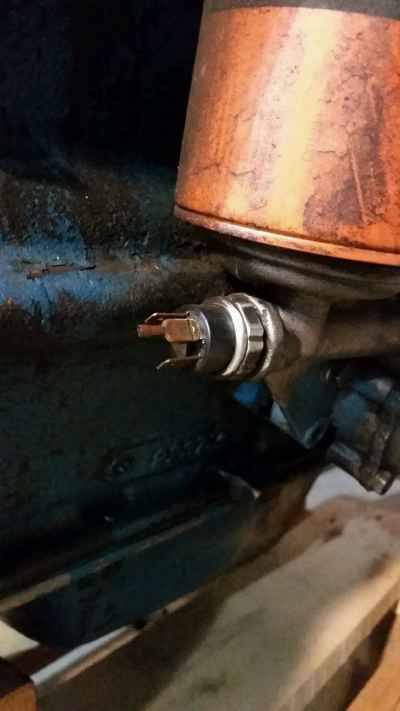

I am assuming that the plug looking thing is what you are talking about correct? I'll see if I can find one on rock auto. And am I correct in assuming that the reading is transferred electrically not hydraulically? Are aftermarket gauges an option?

Ok, re-reading my reply, I left out that what you're looking for is screwed into the oil pump housing, and points toward the rear of the engine. (Just in case I wasn't detailed enough.) If that's where your looking, and what you're seeing is more of a plug than a sender, then someone has removed the sender and put in a plug. I thought your intentions were to have a pressure gauge on the engine while you were testing it out of the car. (And yes, the original sender was either an electrical switch for the light, or sender if the vehicle was outfitted with a gauge in the dash.)
It sounds as if you're looking to put the proper switch/sender in there for the car that you're installing the engine into. If so, you will need to order it for the vehicle, and whether it's a gauge or light in the cluster.
If you want to install a temporary gauge in there for the test run, your local hardware store should be able to fix you up with the fittings you need, just get your mechanical gauge before you shop for the fittings.

Got you Rodger,
I would post a photo, but it's a tad complicated on mobile. Yes, there is a three prong piece in the place you mentioned. As far as the car, it will be a rat rod, so I just need to be able to read the pressure. Aesthetics will be interesting at best. I'll try and post a photo tomorrow.
Hmmmm, that sounds suspiciously like a gauge sender, rather than a simple switch. Either way, it can be removed in favor of a simple aftermarket adapter and compression fitting for a guage, assuming you want the oil pressure gauge in the cockpit. If you don't really need it there, you could put in a bushing or street ell as needed, and have the gauge hanging out in the breeze beside the filter.

GTS225,
Here is a photo of the gauge. I'd like to see your T-bucket. Sounds like it could be a good study. And yes, I believe less is more.

Pretty sure that is the switch for the idiot light (one terminal) and the other two terminals are for the choke assist heater. Don't recall, offhand, which terminals are which. Would need to look at the wiring diagram.

Got you and bummer about the photos. I will get a book for a 78 something and try and figure out the part. Good news is pistons are turning just fine. Odd thing was that I put 4.5 quarts of oil in it as per this site, but it still read high. I drained a little, but left a bit extra in there as the motor is at a very slight angel.
