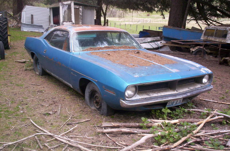

I'm excited, this project has been a slow 8+ years and the wife is on board with getting it completed this year and all the right things seem to be coming together. My dad bought it in '73, parked it in the back 40 @ '87 and it took me 20+ years to convince him of my love of the e-body. soon ..... soon .....
