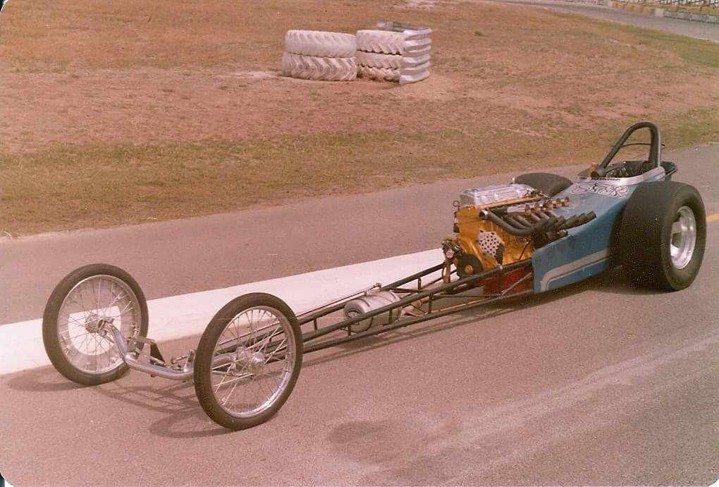

PostPosted: Thu Feb 13, 2020 5:51 am
Do you see what I see...? lol
