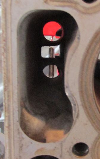

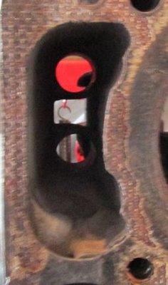

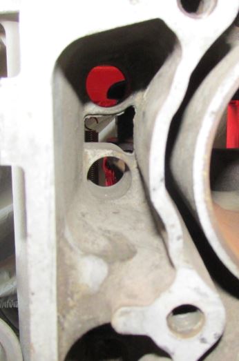

Some images,
Alum block #6 with old correct gasket, Alum block w/steel shim, Alum block.

Yes I think we have the answer. You can use later heads on alum blocks with the right gasket. You can use a 75 up head on any slant (ex hydraulic) so it stands to reason it could also be used on a aluminum slant.
One day I am going to see how much weight I can get out of the 75 up head. I want to be able to get to the lifters without taking the head off. Still like the drool tubes, but better plug selection, better chamber shape, and less chance to leak oil. But that head is HEAVY.
