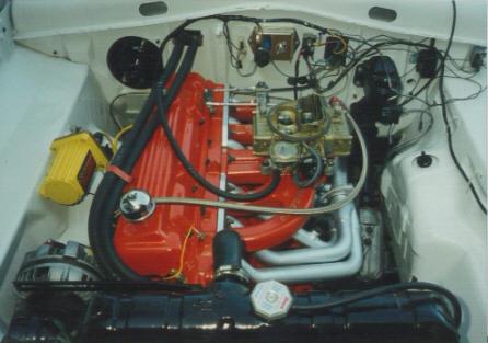

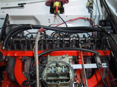

If you want better fuel distribution turn the carburetor 90°. I ran mine with the primaries to the left, away from the head. I made a bellcrank using a bolt in one of the head lifting holes.

Josh,
I think I tried the 90* turn and seems there was not enough clearance between intake and throttle lever on carb to allow full rotation. Maybe I had the primaries to the right, can't remember. Currently using a 1/2 inch adapter/spacer between Clifford intake and carburetor, and a 2" tall air cleaner; it fills space up and is snug to the hood insulation.
I do have a longer throttle cable on hand, so it is just a matter of re-orientating adapter and plumbing up the fuel line. I'll give it a go tomorrow.
