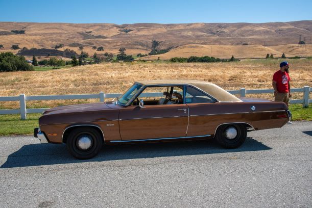

Picture is from this July 4th meet-up/cruise. Dude is not me.
