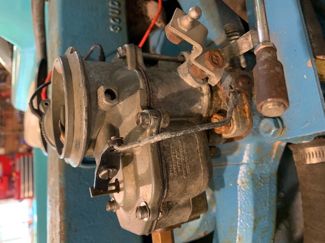

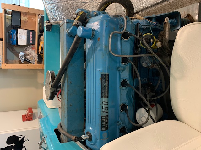

I've put some pics of the boat, engine and carb so you guys can see what you are helping fix and to assit in more expert identification of the carb.

Author:  Joshie225 [ Tue May 12, 2020 1:22 pm ]
Post subject:  Re: M225D Bogs or dies under quick throttle
Carter BBD. If the leather on the accelerator pump cup is in fair shape you can soak it in light oil so that it softens and swells enough to conform to the pump bore. Also, there needs to be a check ball in there so that fuel isn't pushed back out the pump inlet. This works like a squirt gun. There has to be a check valve between the reservoir and the pump so that the discharge goes to the nozzle.

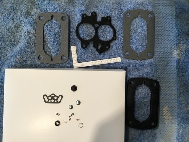

File comment: Also here are the leftovers from the kit. If anyone wants them PM me and I’ll drop them in the mail.
