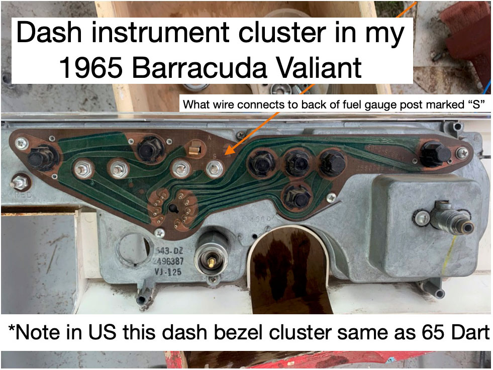

Is there a regulator in gauge of 65 Dart? Or is it possible that it´s working without it? By the way what is that silver round thing back of the gauge in Early A-body Instrument Gauge Problems article of Slantsix.org? I dont have it in my gauges? I mean this picture : Image[/b]

The gauge just left of center, above the pin connector, has 3 terminals... that gauge has a 5v regulator built into it. If the regulator is bad you will have to find a way to bypass it and put on an external regulator or replace the gauge.

I believe that can is a radio suppression capacitor. The instrument voltage regulator (IVR) is rectangular, and I don't see it in your photo.

The can is a capacitor that takes noise out of the 12 v feed. The regulator is internal to the gauge with 3 terminals. On a 62 that is the Temp gauge but I understand that it is the fuel gauge on some models. 12v comes from the pin connector into the left (in the picture) terminal of the gauge , 5v comes out of the center terminal of the gauge... the one with the clip looking retainer on it. If you'll follow the trace from that terminal it goes over to the other gauge to feed 5v to that gauge as well. Ground is through the sending units. Early A-bodies had no external cluster regulator, it was built in to one of the gauges. I believe that changed somewhere around 1967.

Hi Hoping someone can help.
I took my dash out to work on the fuel gauge. On the circuit board there was no wire connected to the "S" post. I've looked at the electrical diagrams, but can't figure out what wire connects to right side of the fuel gauge marked "S"
I've attached a picture.
File comment: What wire connects to the nut on the right side of the fuel gauge?
