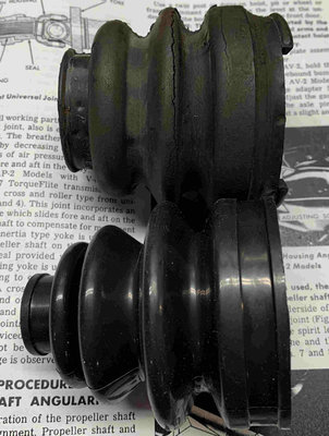

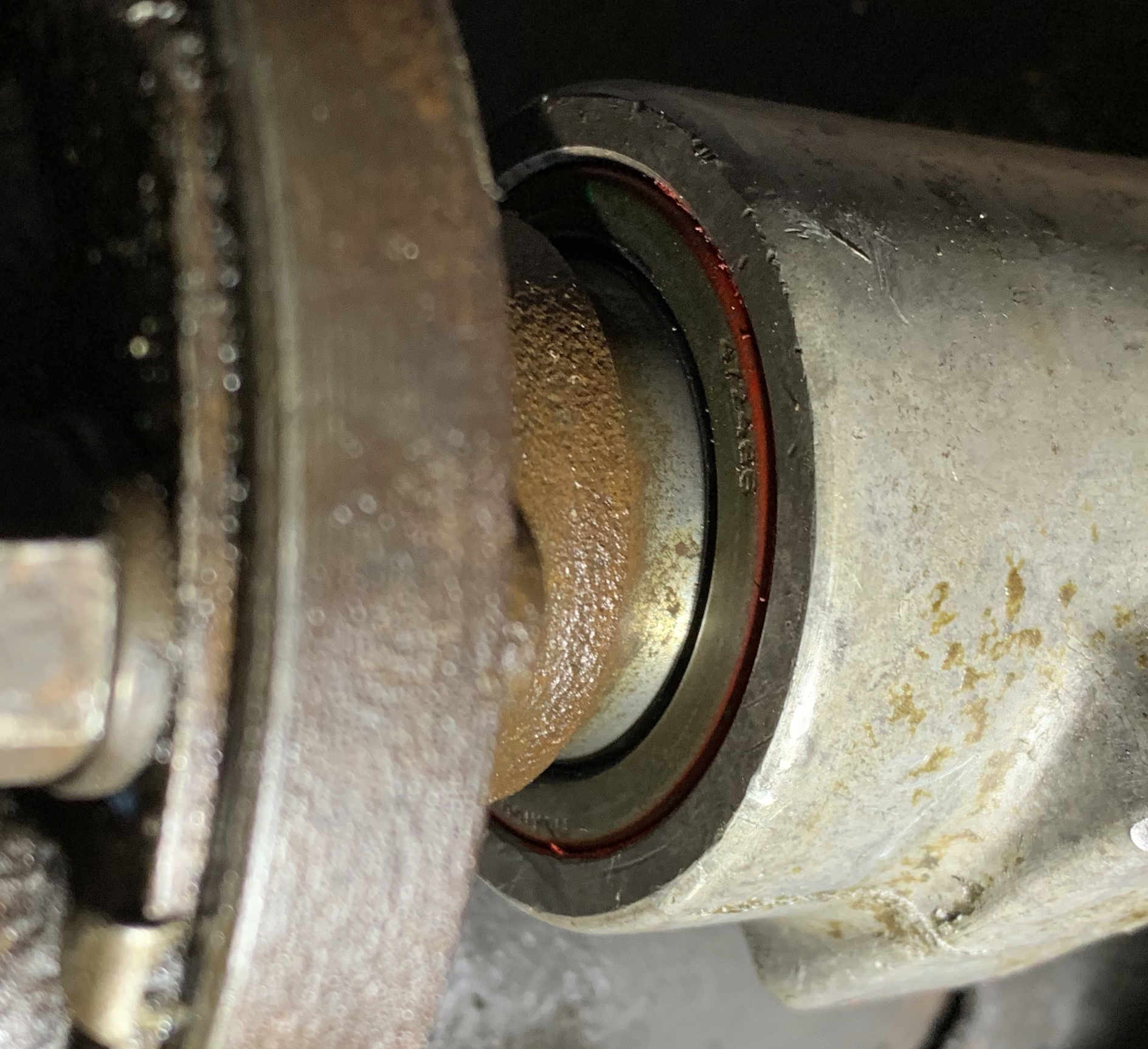

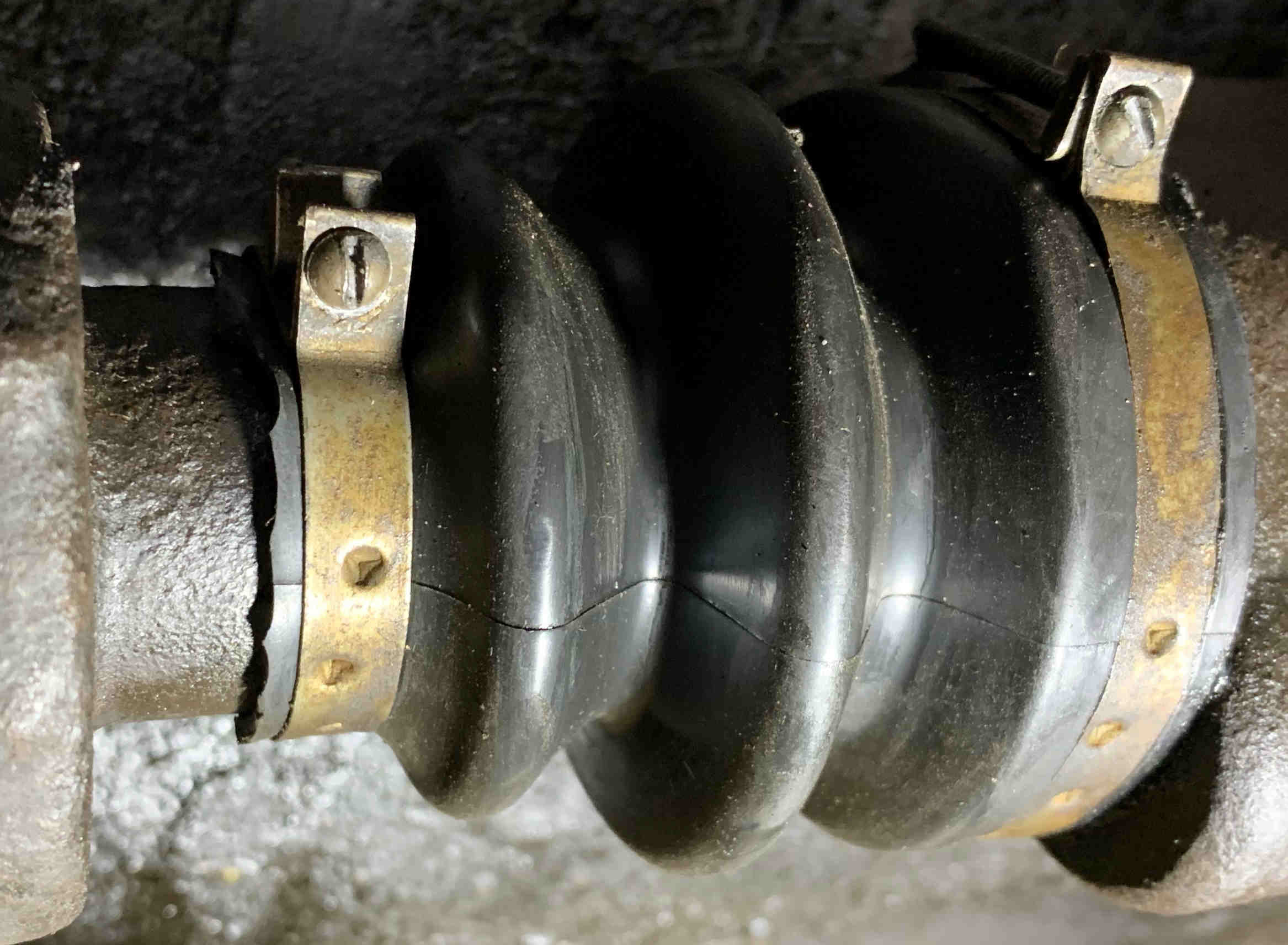

Dried up output seal and resulting fluid leak led me to my latest adventure, replacing the output shaft seal on my 1965 Valiant's a904. This seal (TF6 CT6392 12925A or # 12925A), didn't last long and I thought I'd give this seal (National 472466 Oil Seal) a try. Cheap and easy solution is what I strive for. Trunnion boot was ripped and so I thought this was a good opportunity to get that fixed up as well. I can't speak for anyone else's experiences, but all this talk I've run into about needing a press to disassemble the Trunnion joint seems silly. I found that it has a bearing surface and simply pushed out with a small vice. Removed the pin and replaced the old cracked boot with a new style CV boot, it needed modification but ended up working perfectly. Simply trimmed it with a razor blade. (All Balls 19-5008 Black 17mm x 60mm x 81mm Long CV Boot Kit) https://www.amazon.com/dp/B019QFHRZA/re ... hDbYAX241F

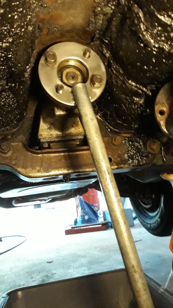

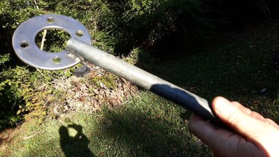

In order to replace the seal, I had to make a tool to hold the flange in place while I wrenched that huge serrated nut and washer off with a large cheater bar.

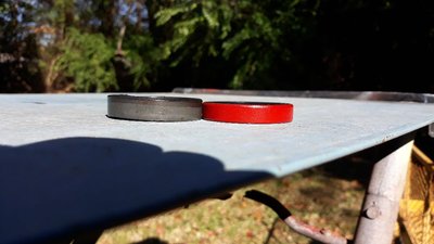

The seal I removed was the stock, factory seal. At the tender age of 55, it is no wonder why it was leaking uncontrollably. As you can see, the replacement is a little thinner than the stock part, but it works just fine. The tool made it possible to remove the flange without the danger of damaging the park mechanism. Big thanks to 225bigblock for finding this part.

Unfortunately, a sad update to this thread. 7 months since the Vega seal was installed. It held for a while, but I am getting drips from the tail shaft again. Not as bad as the crusty 55 year old seal dripped, but enough to make me put down a piece of cardboard on the garage floor.
So.., back to square one. The original seal is a good bit thicker than the Vega seal. Could that be a factor?
