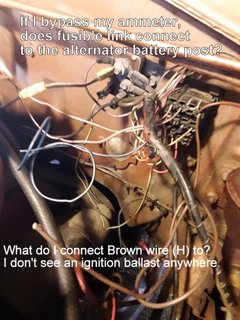

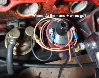

So I've been cleaning up my Valiant, and decided to take out the under dash gauges and the ignition booster and the fancy stereo with the mega-bass in the trunk. There are a s--t ton of wires to deal with. I'm trying to go back to the original wiring. My problem now is that many wires have been cut and spliced with different colored wires running to different places. It's a puzzle to be sure, and I'm no electrical expert. I'm trying to figure out the connections from the distibutor to the ignition coil to the alternator with the regulator to power/battery!? I'm posting some photos with my questions on the photos, if you'd be kind enough to take a look.
Thanks in advance!!

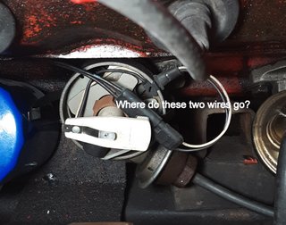

Thanks Dan. I've been using the wiring diagrams. But I'm only seeing one wire coming out of the side of the distributor, and I have two. What's up with that?

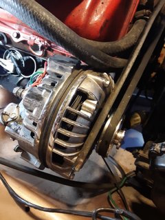

Also, there are absolutely no markings on the alternator so I'm not sure which is Pos. and which is Neg. and if the regulator on the alternator complicates that.
I'm not sure if the PO took it out, but I don't see a separate ignition ballast anywhere on the firewall.

The black and white wires from the distributor are the pickup coil. These need to be connected to an electronic ignition module of some type. What ignition box do you have? Find the wiring diagram(s) for that box so you'll know how to connect it to the distributor's magnetic pickup and the ignition coil. If you want points and a ballast resistor you'll need to buy them. I suggest working with the electronic ignition.
That looks like a Powermaster or other 'internally regulated' alternator. The little box on the back of the alternator is the regulator. The large terminal (1/4" stud) from the alternator is the output and can be wired according to the factory routing, but better than that is to shunt the power around the bulkhead connector. The alternator is grounded through the bracket and block so they need to have good electrical contact.

OK so it turns out one of the things I took off with the gauges and radio and such was a Street-fire Ignition box! I reinstalled it. That took care off some loose ends. Thanks for mentioning that.
So I'm down to the alternator - does the wire from the 1/4 inch terminal run to the starter relay with a fusible link? and where does the other lead go - maybe to the ignition switch (dark blue w tracer)? I'm trying to trace through my wiring diagrams.
The alternator's big output wire will go to the bulkhead connector on its way to the ammeter, but I would not run it that way. I would tie it together with the power feed coming from the battery. Don't disconnect anything, but bridge the connections. This disables the ammeter, but keeps heavy charging currents from going through the bulkhead connector and potentially melting it if the connections are poor. The fusible link should be on the battery feed originally, not the alternator feed, but adding one to the alternator feed is a good idea.
The regulator on the alternator does not get connected anywhere else. If you want to remove that regulator and add the dual-terminal electronic regulator I can help with that. I had one of those alternators come to me and I excised that little regulator in favor of one that can be purchased easily.

I GIVE UP! I guess I just don't know enough about electrical issues and wiring (which I knew before I started this project), but I thought I'd take on a challenge. OOpsie!
I just hooked up the two wires from the ammeter so I could get some power in the dash. I ran them to the wire from the alternator to the fusible link. I hooked up the battery and promptly melted both the ammeter wires. I quickly disconnected the battery but there was so much smoke I thought there was a fire behind the dash. Luckily not. I'm probably lucky it just melted the two wires.
I still think that I should be able to figure it out, but I'm going to cut my losses and call around tomorrow to see if I can find someone to do it for me. I have a feeling it will cost more than the car is worth but I want to get it done so I can drive it before winter.
Should have just left the PO gauges and stereo alone. Live and learn. Thanks for the advice, though. I did learn quite a lot.
