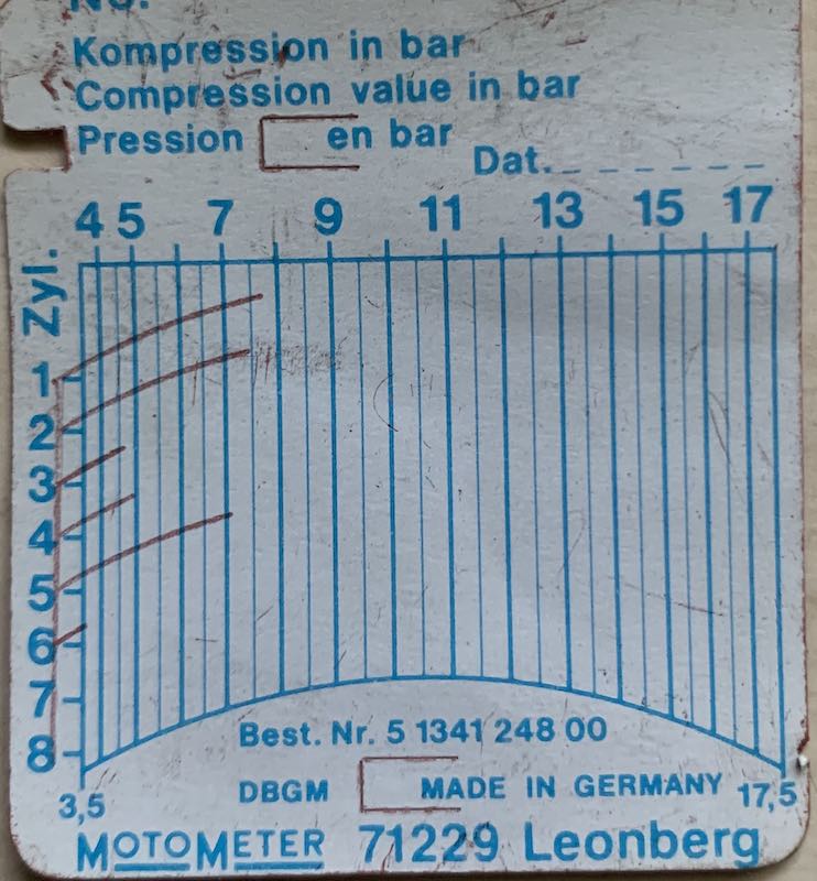

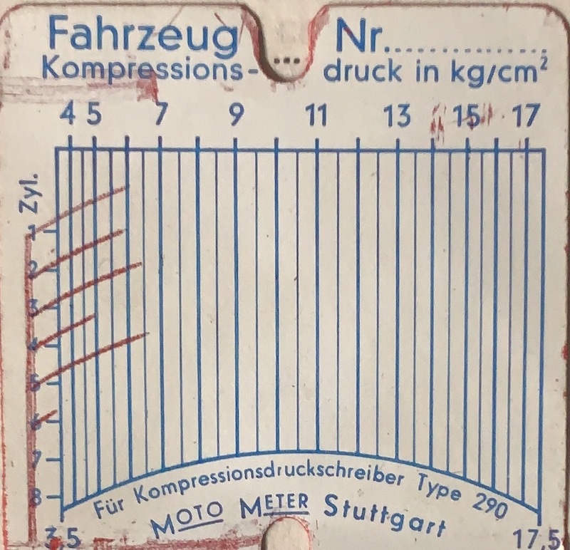

Is it ok when I follow up in this thread with my problem too?
As said, I also have troubles with the compression on my /6...
I was at a garage in my town, they made the measurements in the first pic.
They also did a pressure test and said the pressure at no.6 goes out by the exhaust.
I checked / adjusted the valve lash, tested the compression again (with another tester by myself), now i got the facts as shown in the second pic.
Measurements in bar, not psi. 7 bar is around 100 psi.
As you can see, no one is really that great. Number 6 is almost dead.
What are your thoughts on this one? Burned valve seats? Bent valve on no. 6?
PS: The idle rpm of the motor is noticeable higher since i adjusted the valves.
I think I will now remove the cylinder head and see what I got.
